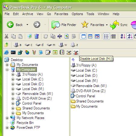

Run each command and verify they disable/enable the HDD in DM (should also see disappear and reappear in Explorer upon refresh). Then optionally create shortcuts, edit their properties to run minimized and even change the icons. Put 'em on your Desktop, Quick Launch, Toolbar or wherever.
I use PowerDesk so I put 'em on the Launchbar, like so (where are more suitable icons found other than shell32.dll?).
