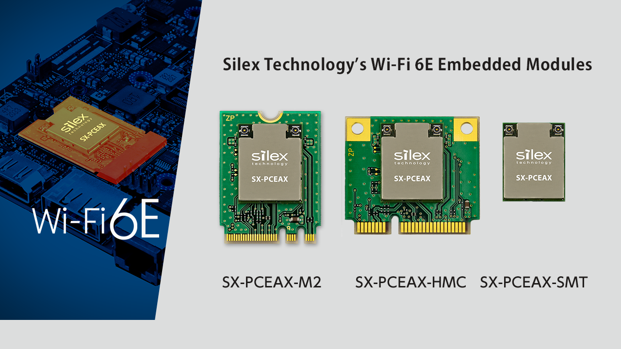

$85 + shipping to make your own 6E AP out of a PC / PI / etc.
I've tried to get my hands on these QCA chips in the past and never could get them delivered. I tried the MTK option and it sucked but, mouser is reliable for shipping. Now, of course the dilemma is waiting on the BE chips to come out that are coming from Intel / QC / MTK and possible BCM. Hard to gauge when they will actually be released for sales as right now they're being dumped for production of "MAX" mobo refreshes for Intel. BE from Intel mouser has listed for Nov restock right now. The problem with Intel as shown above is the hoops you have to jump through to make them work in AP mode at a reduced speed.
Too bad it took over a year to circle back to this with an available card that will actually ship.
