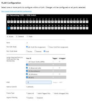

Logging into the switch, I configured port #2 as my General port which is tagging traffic for all VLANs. Great, and for some reason setting this port to Trunk mode only allows for untagged traffic--which I figure must be a Dell thing idk. I assign port #11 on the switch as an access port for use with VLAN 10, and then connect a PC to port #11. Now, I feel like that PC should start grabbing a DHCP IP from the 192.168.10.1 address pool but it never does. And that's where I'm at, trying to figure out why.

What's also trivial to me is that if I switch port #2 to a trunk, I'm not able to tag any of the VLAN ID's on that port. Idk, seems busted... I might just try a Netgear switch instead. The interface on the Dell isn't what I'd call intuitive, yet everything seems to be configured correctly.

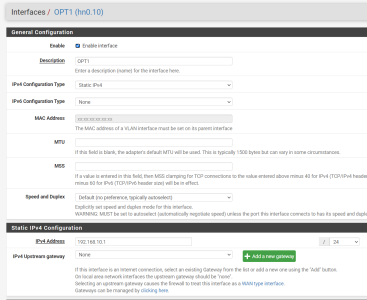

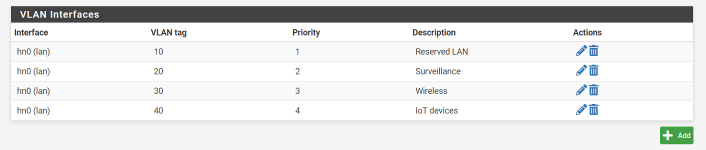

Thanks for the info, here's what I have for tagged VLANS:
hn0 is the lan, which I believe is not tagged because it's the native LAN.

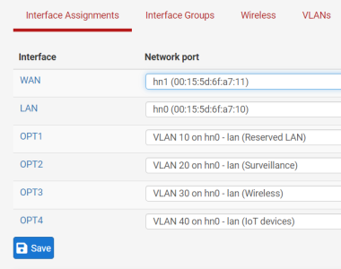

Here's all the interface assignments:
And here's "OPT1" which is VLAN 10's config:
As far as I know I have all of this set up correctly, but here's where I think I'm losing my mind slightly:
If I set port #2 here as the trunk and select all VLAN ID's, I can only set them as untagged. Since the trunk is meant for all traffic that makes sense, but then what is actually tagging the traffic? I assume it's the firewall but I feel like the traffic just isn't getting tagged and routed to where it needs to go...

Good pictures. I'll start at the Dell switch...So those VLAN's are greyed out and labeled untagged, but you had to configure those VLAN's on the switch. Are those configured as "untagged" in the VLAN configuration? If not, I find it a bit odd that you can't edit those to tagged. So I'm thinking check the VLAN configuration page.

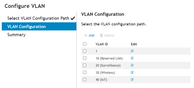

Thanks for the help, here's the Dell switch vlan config page:
As for DHCP on the VLANs, I read that leaving DNS blank would use the default DNS on the parent interface (which may not be accurate), but then I went and manually keyed them in for each VLAN. Didn't seem to do much unfortunately.

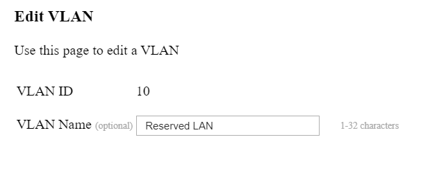

Ok, click the edit (config) on one of the VLANS 10 thru 40. Is there a tagged / untagged option in the VLAN configs?

No worries, this is all that shows up when you click edit for any of them:
You had mentioned updating the switch firmware but honestly this kind of makes me just want to try one of the others i've got lying around.

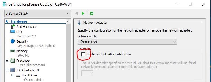

I think I may have found the problem to everything... I've been at this for so long on and off that I completely forgot my current pfSense appliance is a VM; I don't think VLAN ID is enabled, or it got turned off somehow, for the virtual switch.
So, I gotta go into my notes from awhile back because I can't remember what this should be set to... I think the native LAN "1" but not sure. It did kind of feel like VLAN info wasn't leaving the firewall, and I think this could explain why.
Yes very interesting. I didn’t think to ask, just kinda assumed u were running a standalone box. If this is your main main network and not testing…maybe a standalone?
I had been running a standalone on a SFF PC awhile back, but I think I ran into some kind of compatibility issue with pfSense, so I moved it to a virtual. I'm almost wondering if when I re-created the VM more recently that I neglected to account for the VLANs. I'm pretty sure I had them working before, so I'll just plug away at it. Worst case scenario yes, I'll try a standalone. There have been some updates to pfSense since I first tried, so worth a shot.
