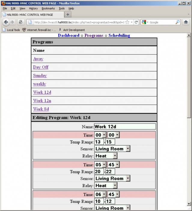

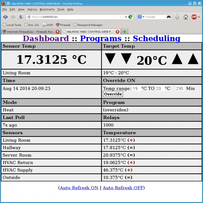

That's basically how my hvac system works, I have different profiles that I can set for each day based on my work schedule.

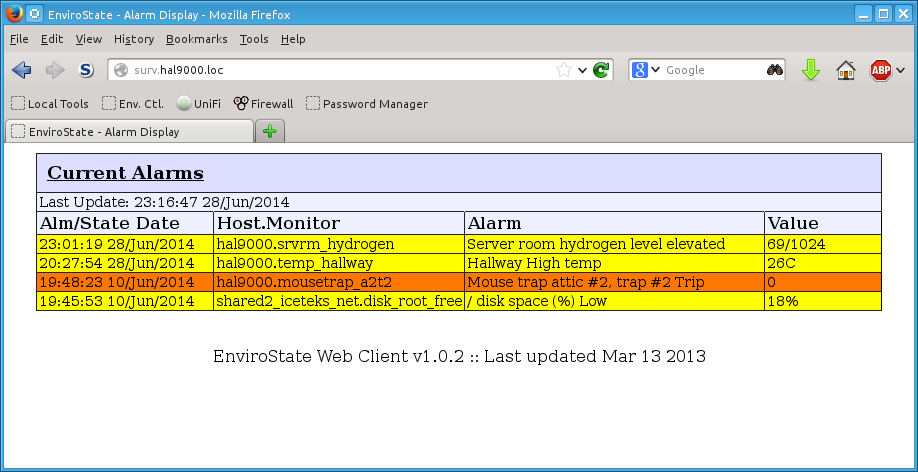

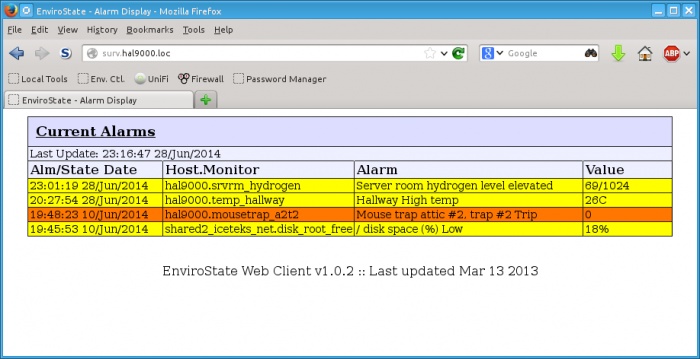

Also have all sorts of monitoring stuff:

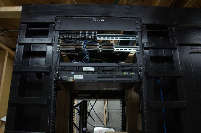

Right now the system is kinda a mess though as it started off small and just kept adding stuff and it was not planed out right. Will be redesigning it from ground up to make it easier to manage and add new sensors/controls. Going to use bitshift registers as well to add way more IO ports.
The DIN rails are just for distribution of power/cross connects, there's two boxes on a shelf behind that house an arduino and relay board (got it before I knew about arduino).
The nice thing with going fully custom like this is the possibilities are endless, you're not dealing with something proprietary or expensive and you're not relying on some 3rd party service, like a lot of the existing solutions out there.
