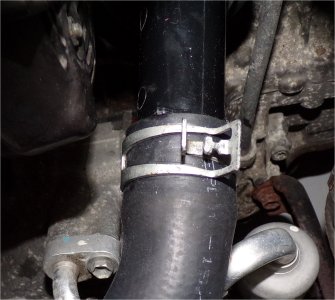

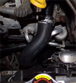

After replacing the radiator and hoses 2 weeeks ago, I appear to have a leak on the lower hose, on the upper connection to the thermostat housing. At least it's easy to get to. It's been two weeks since I did the repair, but I don't drive much, so it only went for a couple drives before a trip yesterday. It's a 2009 Camry, see other thread here:
The day I replaced the rad, it ran in the driveway for about an hour. No leaks. I have driven the car three times since. And I have been checking for leaks every couple of days, because...I'm paranoid, and because I wasn't sure if I got all the air out, so also checking the resevoir levels.
1st drive, 14 miles each way to the dentist a couple days after I replaced it, stop and go traffic all the way. No leaks, checked it when I left the dentist, and when I got home.
2nd drive, went to the grocery store, 15 miles round trip. No leaks.
3rd drive yesterday. I went to visit relatives 75 miles away. When I got there, I checked it right away, still no leaks. I drove about 8 miles to another relatives house, and checked again (told you I was paranoid). Several drips from the hose where it connects to the thermostat housing. I drove 70 miles back home, and stopped to fill up the gas tank about 5 miles from home. No leaks/drips visible at the gas station, but when I parked at home 5 miles later, there were a few more drips.
After I wipe it up, it doesn't appear to leak while just parked. It's been sitting overnight, still dry. It's been about 45f or so each time I've driven it.
So what is the solution? They are brand new gates hoses, original Toyota spiring clamps in good shape. Should I try any kind of sealant? Would it help to just re-adjust the clamp to a new position?
Other than this, it seems to be cooling perfectly. Temp gauge reads exactly where it did before. I was concerned that the thermostat wasn't opening, because the lower hose stays fairly cool, about 85f to 90f. Upper hose is 175f at engine end, 160f at the radiator end. So I took my wife's car (2009 Camry just like mine) and had the same results, lower hose stayed cool, temp readings were within 5f of mine, both upper and lower. But I only went about 20 miles. I'll assume that's normal for a 45f day?
Any suggestions would be great. I hope I don't need to dump all that fre$h coolant. @crashtech , since you do this for a living.
Thanks.
Here's pics, doubt it helps:

I would try to get rid of the spring clamp and use a regular worm gear clamp, if it is possible.Re-positioning that original clamp might help. Sealer on the inside of the hose might work too, but I just dont trust those spring clamps. I leave them alone it they are working though. I hate plumbing of any kind, but it's a necessary evil :)
Since it's only leaking a few drops, it may eventually seal, just from heat and temp cycling.
But if you do decide to replace the clamp, be sure to look at the inside of the hose, just to be sure it doesn't have some defect that's causing the leak.
Oh yeah, DON'T dump that expensive antifreeze. Catch it in a clean pan (like one of those cheap plastic oil drain pans). That new antifreeze can be re-used. Pan doesn't have to be perfectly clean, so you can just wipe down whatever drain pan you have, just be sure it's big enough to hold whatever the coolant capacity is. Or use two pans and switch them out quickly.

It's a plastic thermostat housing, yes? If so then I would carefully inspect it for cracks, and also take the hose off, feel the inside for irregularities, make 110% sure that the housing nipple is clean/smooth, and replace the original spring clamps with new spring clamps. The cheaper option is take the spring clamp off, and compress it into a little tighter radius, then put it back on.
Since (if) it is a plastic housing, you could get away with using a worm gear clamp (the plastic does not have same coefficient of expansion that a metal nipple would, so lessens the impact of lack of expansion that a spring clip provides) and I might consider doing so if they are significantly less expensive, but otherwise would just get a new spring clamp.
A sealant might also solve this but shouldn't be needed and could end up being a pain to deal with if/when the hose needs taken off at a later date.
Why would you need to dump all that coolant if only disconnecting something (presumably?) that high up in the cooling system? As Jimminy mentioned, you can just catch in a container what leaks out, and if there's grime in it, run it through an old t-shirt/rag over a big funnel to filter it "good enough".
This connection is about 4 or 5" below the top of the radiator, so it will pour out coolant. I could drain out a couple of quarts first. I did inspect everything, and clean all connections when I first did the job. The housing and nipple was smooth and clean, and didn't leak before, so I'm pretty certain it's not cracked. Hose was nice and smoth inside. Oddly the other (upper) hose wasn't quite as smooth, but is holding fine. Both are Gates.
As far as worm clamps, I never use them on plastic. And it gets really cold here, which often causes them to leak. Plastic expands and contracts, more than metal, not less.
I just re-positioned the clamp a couple mm farther from the barb/nipple. I looked at the old hose, and it was a little farther from the barb than I had it. Also rotated the hose slightly left, and rotated the clamp to the right. Hoping it just wasn't quite right. I've never had issues re-using spring clamps before, and this was the first time it was ever removed.
I let it idle in the driveway for 35 minutes, so far so good. But it took two weeks to drip the first time, so who knows? If it drips again, I'll get a new spring clamp, but Toyota wants $25 for them! Old hose in first pic.

Could be that the aftermarket fellas(hose, rad, or both) didn't quite get the measurements down right. (I just had an experience with a bad phone screen replacement where the LCD had no touch and the screw holes didn't fully line up.)
I'm not sure how much it matters in actually, but some say no to worm clamps for the heated liquid system due to expansion cooling. .
I used the old clamps for my mom's Corolla Matrix and the original hoses....at 100k.
It's not leaking at the radiator. The hoses fit good and snug. I was surprised it took a little effort get the new one to rotate a little bit, since it was only on for two weeks.
I probably could have re-used the OEM hoses, but I didn't want to risk a leak with 14+ year old hoses. Go figure.

I checked that. The connection is above and almost a foot to the right of the water pump, and completly blocked by the engine and components.
It was replaced under warranty from a tsb. When they leak it's easy to see. It leaves bright pink dryed coolant on the underside of the hood, from the belt slinging it. Wife's did it too, supposed to be a new revised part.
