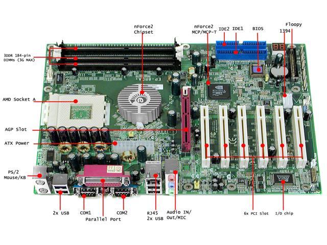

i have the older version of the mobo this one
http://images10.newegg.com/pro...mage/13-123-191-12.JPG
unfortunatly it doesnt have the orange plug, looks like i need to purchase a new sound card with that plug on it damn. i have an extra turtle beach santa cruz sitting around would u reccomend slapping that in? does that have the digital out option? would that even be better then the onboard overall even if it doesnt solve this situation?
Perhaps there is an expansion plug on the mobo for use with digital audio bracket.
