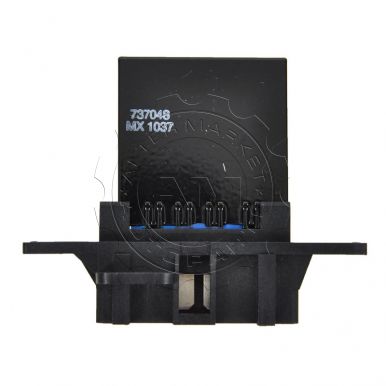

On your car the resistor is right next to the blower motor behind the glovebox. It has one electrical connector and has 2 phillips screw holding it on.
They show 2 parts numbers for that resistor .. not sure which one your car requires.
You may need to check with Nissan to see which one you require.

Part Number: AM-15713845
Specifications:
  • Direct replacement
  • Replaces dealer part numbers: 271501E405, 271502J000
  • Built to strict quality control standards
  • 100% tested prior to leaving the factory
  • 4 Terminal connection
This part replaces:
  • OE #: 271501E405, 271502J000
  • STANDARD MOTOR PRODUCTS #: RU212T
http://www.partsgeek.com/catalog/1997/nissan/altima/climate_control/blower_motor_resistor.html
Thanks I found a video online and it looks fairly easy to swap the resistor. I think I will try that. Still trying to decide what to do with the heater A/C climate control unit. Picking one up on E-bay for $30 doesn't sound bad. However getting the actual unit replaced will be the tough part.
Thanks everyone for your help. The motor blower resistor has been swapped out, very easy and doing it myself I am sure saved me money. The speed settings are working now.
