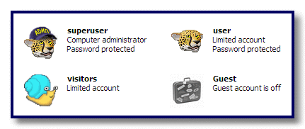

To check if you have a non-Admin account, go to the Control Panel and look in the User Accounts, and it'll say underneath each account if it's a Computer Administrator or a Limited account. Like this:
On this system, superuser is the Admin account, and user is the "daily driver" Limited account
Limited is the one that's a "padded cell" :) The account that's actually named "Administrator" is the system's own Administrator account (this is why it only shows up in Safe Mode), but Windows will require you to have at least one Admin-level account of your own before it'll let you have a Limited account. So if it turns out you've been using an Admin-level account, you can create a new Admin-level account, and then you'll be allowed to switch your own account down to Limited.
