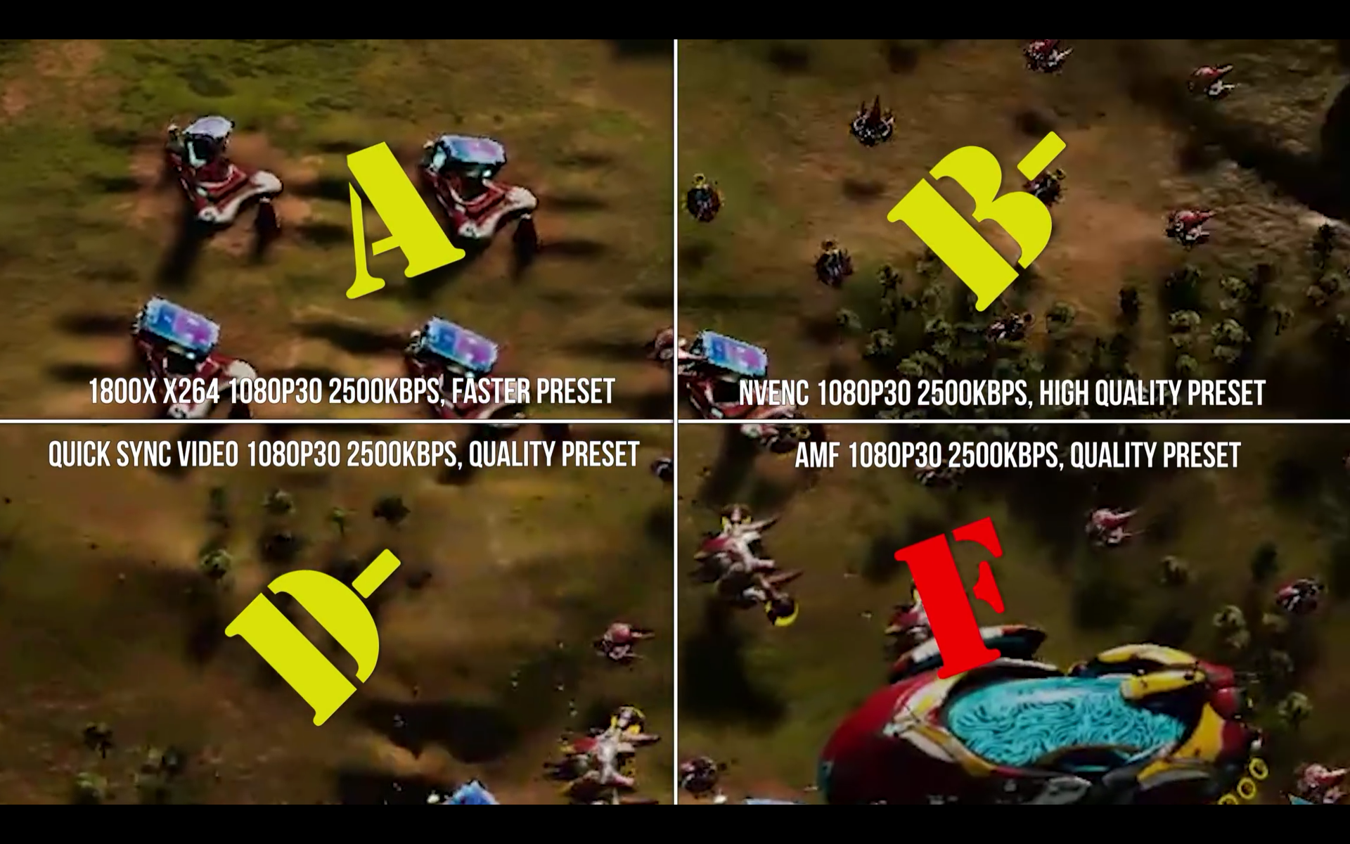

I don't know about decode, but if you are going encode you might want to conserve quality with software encoding. Ryzen seems to be up to the task. *Taken from Linus Tips:*

mtcn77 - not sure what Linus is referring to - do you have link?
Old Quicksync Video 4600 (on the 4790K) had encoding had quality issues but Kaby Lake iGPU has improved and actually has two encoding settings for speed vs best quality.

It was the streaming quality challenge.
You'll be okay with either cpu; that is the essence of it, imo. Software encoder is the best(more compact).
Software encoding is not a problem but both encoding and decoding are CPU intensive. Using the Intel iGPU makes both faster using hardware acceleration. Neither Ryzen or new Intel i9 series have iGPUs so we can't compare them to to Kaby Lake i7-7700K. New 7740X has disabled the iGPU.
That's the real time aspect of the benchmark and QuickSync is a touch faster than 6900 with ShadowPlay. The quality feature also pertains to your benchmarks.
With enough time in hand, more strenuous settings can be utilized; I recall somewhere at another source these 'faster' settings were disproportionately lacking in quality, so it is all irrelevant.
What I want to see is decode benchmarks with MadVR. There is not much necessity pushing encode to consumer hardware, imo. Let's see super-XBR upscaling to 4K, etc.
