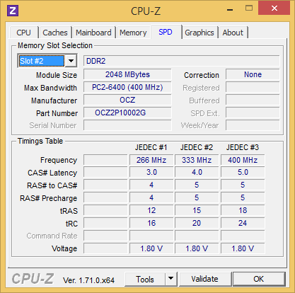

The RAM I was using is two sticks of OCZ Platinum DDR2-1000 5-5-5-18 2.1V

So I took your advice guys and ordered two same 2GB sticks as my two OCZ.
Luckily a couple of days after I started this thread, some good guy put his OCZ for sale on Ebay and I instantly grabbed them.
The result is that the system now runs happily at 4Ghz again with the same BIOS settings as before. So BIG THANKS! I didn't know mismatched memory could hit OC so hard.
