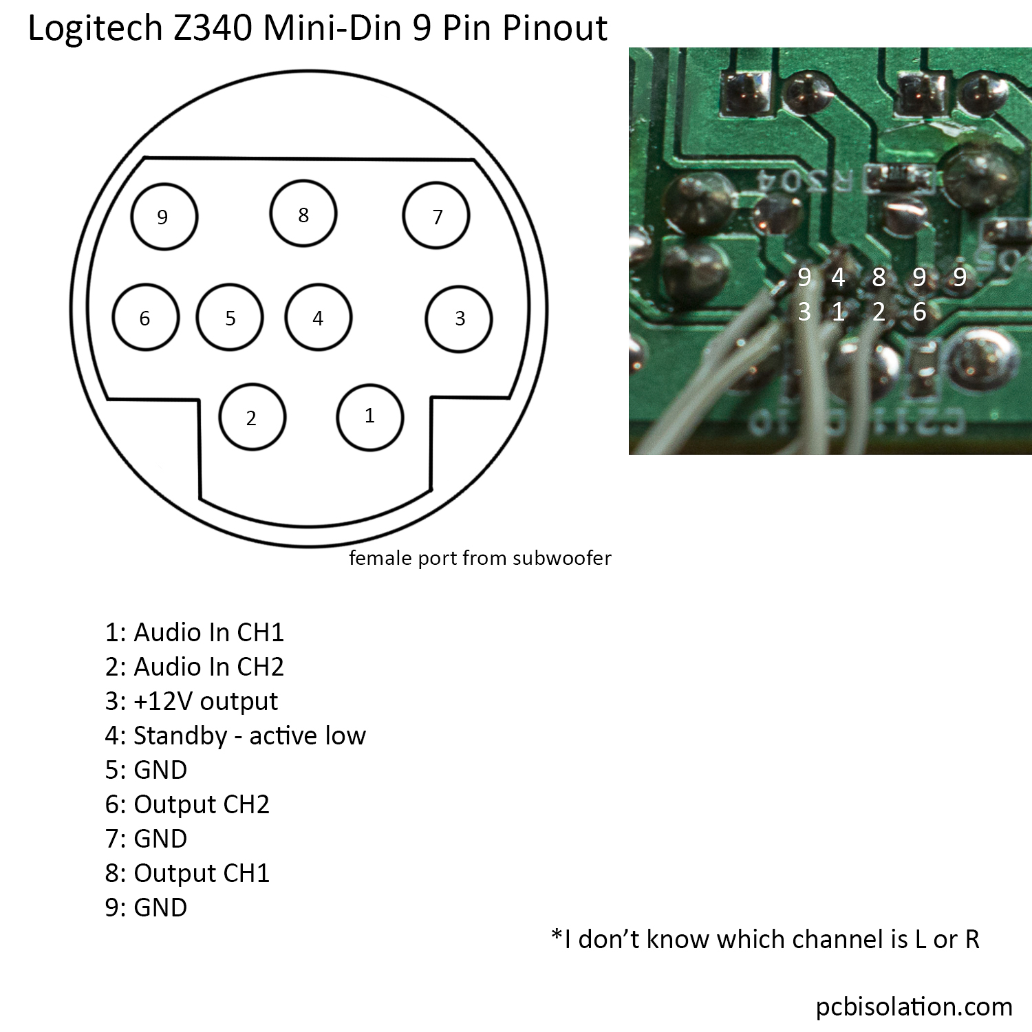

Ok so i have a logitech z340 subwoofer, the 9 pin din connection cable is thrash and no i did not destroy the cable the sub was given to me that way. ive been tinkering with it for a month now and i cant not for some damn reason figured out how i can wire the Sub amp pcb with connections to retrofit or MOD to my home theater reciever. Plz somebody help me figure this out im ssoooo frustrated with this issue. Ive include a pic of wat the amp pcb inside the sub box looks like and as to how it was wired to 9 pin din cable also details wat each idvivual pin actually is. O! p.s im trying to wire a single RCA connection cable from PCB to reciever becuz i need it to plug in preout on the reciever it can be as many wires as it takes sodered to the PCB as long as the end is just a single RCA connector. Thanks for ur time and energy helping me out if u can.
you want to connect to your home theater?
then trash it and buy a sub
honestly @ 20watts its not worth it
