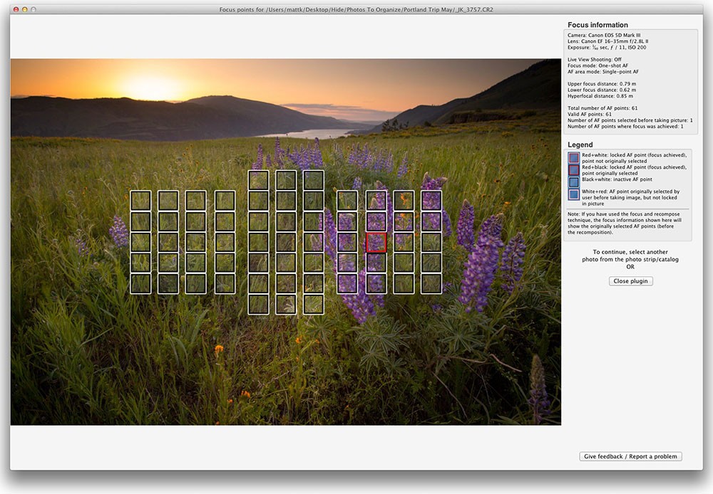

If you were controlling the focus point and had a shallow DoF, I would have expected one of the people in the middle to be in focus. My guess is you're in auto-AF and the AF system chose the person in the bottom left to focus on.
If you're a Canon shooter, I think their software has an option to show you which focus point was used. You should also check into that as it could definitively show the issue.
Alternatively, there is a plug-in for LR that shows the focus point used.
i.e.,
i.e.,
This is great info thanks! I'll look into installing that plug-in. As far as the EXIF data, what image hosting site shows that info?
