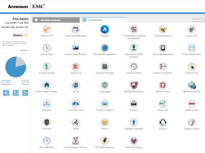

My current problems;
I still would like to figure out the Linux type install, but its going to take a seriously for dummies' version.
IX2 was sold as DL, disk less, or with 2x 1 or 2TB drives. DL has some chip on the MB with OS, the other models have it on the drives, which makes drive upgrades a PITA which I have not figured out yet, but I am getting really good at swapping out the drives, all combinations and sequences I have tried without getting the two new 6TB drives to show up at the same time. One original drive and one new drive works sometimes, others not. Working on the issue right now. Factory reset appears to have made it worse, defaults to RAID1 and won't init either drive, vs old setting was protection "none" ie JBOD, which worked at least some of the time.
Old software, little formal support, so a bunch of apps on the NAS don't work, one of them appears to be whatever is needed to get a new SSL certificate.
mikeford
Jan 27, 2001
5,671
160
I don't know if I have figured out replacing drives on a non DL (disc less, with boot on rom not drives), but I did eventually get 2x 6TB in a JBOD working on mine. I tried one new drive at a time with each of the original 1TB drives, and didn't work. Key maybe doing a reset and creating a new data pool with one new and one old drive, and that requires turning RAID off, ie setting it to NONE in drive management, which you may need to do using both original drives otherwise it may complain it can't create the data pool. RAID1 is the default setting after a hardware reset.

Found this tidbit for restoring messed up unit.
Additional tips:
1. Don’t forget to remove all HDDs from the nas before the procedure. Otherwise all data will be removed.
2. download .zip via this link (for PX4-400d it is https://download.lenovo.com/nasupdate/asgimage/b4b-4.1.406.34763.zip ) -> unzip -> launch .exe -> select USB drive -> install image. If during the installation you’ll see an error just cancel the installation, do nothing with USB drive (don’t format it again) -> restart imager and set same drive letter during the installation.
3. Put the USB drive in TOP LEFT USB PORT on the back of the device -> push reset button on the back using someshing like a pin -> turn the device on and wait 60 seconds (don’t release a reset button during this 60 seconds).
It works for me. PeteLong thanks a lot for the instruction. You are my hero! =)
Thread is here https://www.petenetlive.com/KB/Article/0001381
