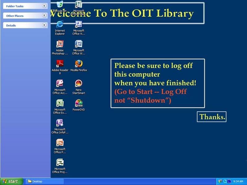

Occasionally when we log into that account, there's this issue with the desktop have the right side of the explorer window is on the desktop.
http://i146.photobucket.com/al...weirdactivedesktop.jpg
Yesterday I spent most of my day installing audio drivers on all our computers. I got most of them done and I finished the last few this morning. The 2nd computer I logged onto had the problem in the pic above. I didn't see it all day yesterday.

The desktop issue you have shown in the picture is...wow. Never seen that.
