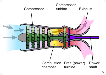

The jet's output shaft mates directly to the Ford torque-tube (no transmission.)
What? So the turbine is capable of running down to 0 RPM and then starting back up again? I could understand if there were a torque converter like an auto transmission, but from my understanding of the torque-tube, it is pretty much just a beefed-up driveshaft.
The turbine cannot go to 0 RPM, but the output shaft can:
Think of it as a higher-Reynolds-number torque converter.
Ah, I see. Thanks for the diagram. I guess I had never seen a diagram for a non-aircraft turbine before. So it basically has a built-in torque converter that runs on air instead of transmission fluid.

Compressor turbine keeps the engine self sustaining. 1500+ HP comes from a single second stage freewheeling power turbine/shaft that just sits in the exhaust stream. It can be stopped completely and spin at any rpm independently of engine RPM making a torque converter or transmission completely unnecessary
