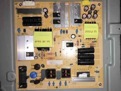

I picked up a replacement power supply board and it no worky. So that would leave the LED driver circuit but I am unable to find it. It does not appear to be integrated on the power supply board? Or is it and I just don't know what to look for?

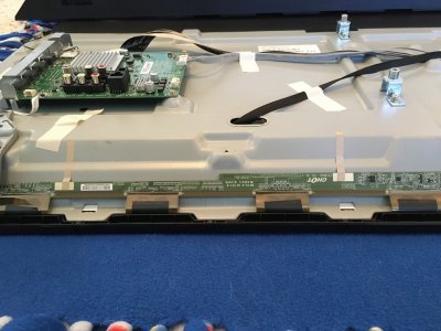

Unless the LED driver circuitry is on the underside of the aluminum shell on which the other boards are mounted? See the black cable (coming from PSU board) making a dive through a hole:
None of the parts dealers list any kind of LED driver board as separate circuit for sale for this Vizio V-series family/model. Could the T-CON board to be the culprit?
