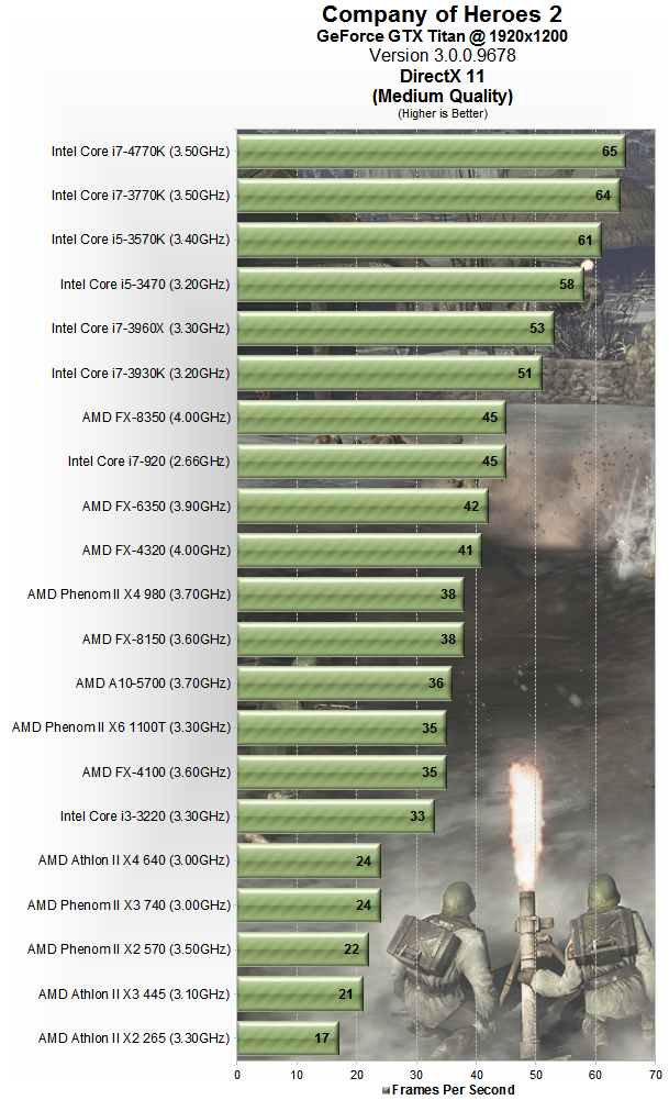

At high resolution I am only getting an average of 29 fps. Is that normal? Do I need to upgrade already? The card is only a little over a year old. Will the gtx 760 4gb be an improvement?

I'm getting about 50fps in the performance benchmark. SLI/CF is not supported for this game. I'm assuming that it's somewhat CPU bound, which might limit how much of a boost you'll get with a GPU upgrade.

So my A8-3870K is the weak link?
It's not unlikely.
Also, are you getting 29fps, or something like 29.97 fps? If the latter, is vsync on? If it's on and you turn it off, you might see higher numbers, but you may also see tearing effects.
If you really are under 30fps, I'd say try overclocking the CPU part of that A8 a little to see if you can get to 30fps or better. Then maybe turn on vsync to lock in 30fps.

The HD 7950 and GTX 760 are on nearly the same level of performance, and 3GB is overkill for 1080p as-is.

An A8-3870K will bottleneck a 7950 in almost any demanding game. CoH2 is, as games go, extremely CPU heavy, so your performance suffers doubly in that game compared to other games.

Thank you everyone for their suggestions. Turning Vsync off increased did indeed increased my fps. I now have an average of 32 fps. What is weird is if I turn my sound quality to high the fps drops to 28. something. Why would sound affect fps? Nonetheless, I put sound quality back to medium as I really didn't notice anything different between medium and high.

Sound processing uses CPU time. The drop in FPS just goes to show how extremely CPU limited you are.

Time to pick up a i5-4670k ;)
760 is a downgrade from the 7950, if you're overclocking.
