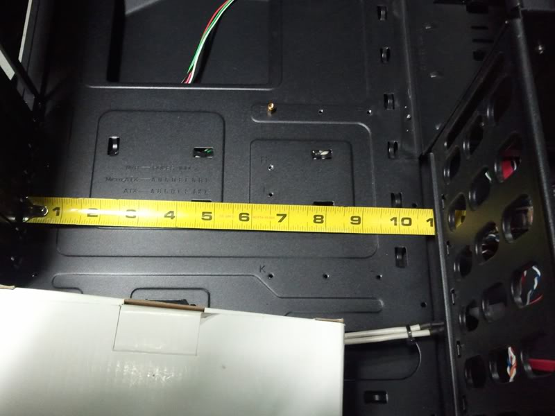

I'm in the market for a new GPU to replace my GTX 560. My budget is about $230 its actually stretched so i can't go any higher. I'm wondering which would be the best card to get between the HD 7870 Tahiti LE or HD 7950. I game at 1920x1080 and do want some nice eyecandy. I do intend to overclock the card as much as i can get out of it. Games i play Battlefield 3, Crysis 3, Far Cry 3, Sleeping Dogs, Hitman Ab, Assassins Creed III, Batman Ac, Borderlands 2, Devil May Cry, Max Payne 3 etc.. The card also has to be under 10.6" and i don't mind buying Pre-owned either. Also please don't comment about my cpu potently bootlenecking as i do plan to upgrade to a FX 8320 either next week or the week after.

I don't think i can stretch my budget any further as i'm already $30 over. So it's gonna have to be used.
These are under 10.6"
MSI R7950 Twin Frozr Radeon HD 7950 <--- Best out of the bunch
http://www.newegg.com/Product/Produc...82E16814127667
XFX Double D FX-795A-TDFC Radeon HD 7950 3GB 384-bit GDDR5
http://www.newegg.com/Product/Produc...82E16814150588
XFX FX-795A-TNFC Radeon HD 7950 Core Edition 3GB 384-bit GDDR5
http://www.newegg.com/Product/Produc...82E16814150590
MSI R7950-2PMD3GD5 Radeon HD 7950 3GB 384-bit GDDR5
http://www.newegg.com/Product/Produc...82E16814127719
And i'm sure it can't fit any longer without a HDD drive bay modification

the MSI HD 7950 twin frozr cards are now coming with boost BIOS - 880 mhz core , 960 mhz boost and with 6 + 6 pin. but the problem is there are few older MSI HD 7950 twin frozr cards at 880 mhz which use HD 7970 PCB with 8 + 6 pin. they are 11 inch (279 mm) long. so unless you know the exact card you are getting its difficult to say if it will fit in CM Scout.
http://www.overclock.net/t/1332900/7950-msi-or-xfx-dd/10#post_18725170
http://www.coolermaster-usa.com/landing/scout/faq.php

MSI TF3 R7950 is right around 10.5-10.75 inches. Order from Amazon if you have prime. No problems with a return in case it doesn't fit. The new game bundle is also good there.

I should add that I measured the R7950 myself. About 10.5 from edge to edge (including the slight overhang from the cooler) or 10.75 including the lip of the case bracket where you lock the card down in the case.
not bad might be a tight fit
