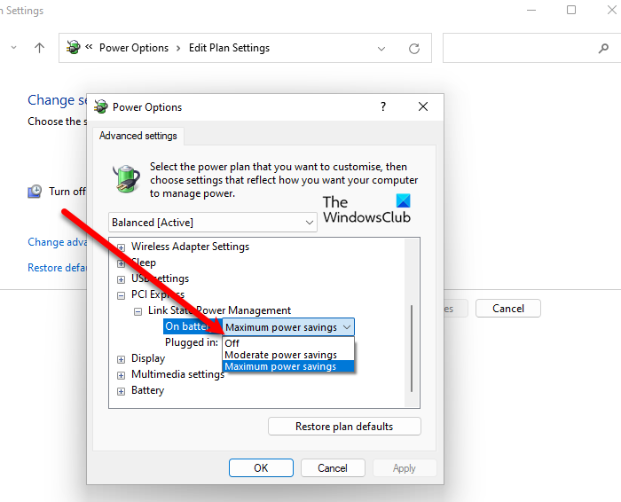

  • Editing the power plan to “never” turning off or going to sleep when plugged in. Also, under the advanced power settings, making sure to turn off the “link state power management” under the PCI express. There was no change in the issue after doing this.
