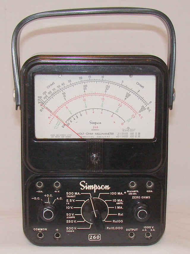

That meter will do fine. You can use a Simpson 260 for this kind of thing if so inclined!
