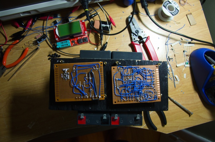

The MCP2221 (actually I guess the A version might be better now) chip is pretty nice if you want to add a UART to a bare chip too. I got the process down path now for building Arduino based projects without an actual Arduino. I'll use the Arduino for testing but once I want to make it a project that I keep I just use the bare chip.
I need to take the time to learn Kicad properly though so I can get some PCBs made for future projects, the time and effort I save will be worth the cost, so I don't have to do this again:
That was more tedious and harder than it looks haha.
Don't mind that weird solder blob, that was a makeshift heatsink for a linear regulator. LOL.
