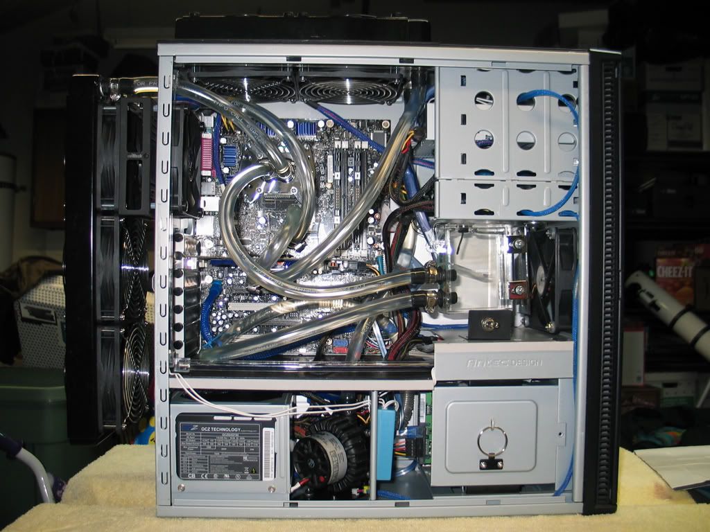

My P180 on water
The MCR320 off the back only blocks one video port. There's still room at the PCI slots to plug in sound cables or other small cables. The only mod I did for that was holes at the top for tubing. The mod for the top rad is a different story.
If you remove the middle HD cage, you can fit the MCP655 there as well as the MircoRes.

Very nice. The picture of yours was what actually "sold" me on the case. It's not as elegant as a TJ-07 or similar cases, but it's also much more portable.
Was the RadBox hard to set up, and does the radiator feel like it's going to wobble or fall off? My girlfriend has a 3 year old, so I'd like to avoid any possible accidents. Great kid, but they get curious. :p
Also, where are you running your fan cables?
Great job. Looks really good.

The rad box is easy to set up and once the rad is on it's remarkably stable. Now if the little one started pulling really hard on it, she could do some damage, but I've bumped mine pretty hard several times without any problems.
I made some very long, sleeved, three pin extensions that run to a small grommeted hole for the cables that's above the I/O shield. From there the cables run behind the mobo tray and forward to a fan controller.

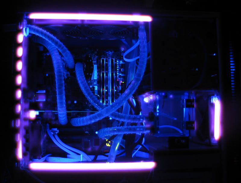

This is my most current pic under UV. :cool:
