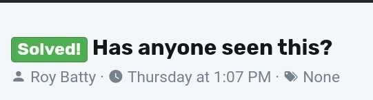

lakedude
Mar 14, 2009
2,778
529
Sorry, I was asking about the green "solved" graphic in the title of your post.
When I look I see options like "question", etc. But not "solved".
