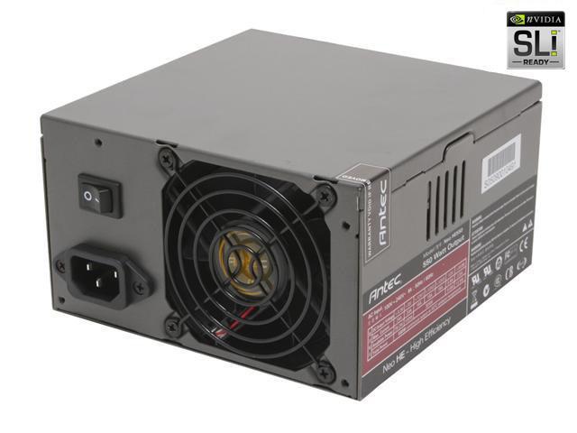

I would mount the rad externally with a radbox to the 80mm fan on the back of my PSU. The whole WC setup rest on my ability to mount the rad to the PSU because there really aren't any other externally accessible fan mounts on my case and as such, no where else to mount a rad. I have no problems voiding warranties. Antec makes multiple PSUs with rear mounted 80mm fans all the way up to 850 watts so I am not worried that having to get a new PSU would ruin my WC setup.

My plan was to hang a 120x2 off the back with a radbox connected to the 80mm fan on the PSU. Putting one anywhere else on my case would either mean just leaving it loose or having to mod the case. I was hoping to avoid modding the case but if you can give me a compelling reason why hanging it off the back would be a bad idea or tell me why its better to have it on the side I might give it a shot.
