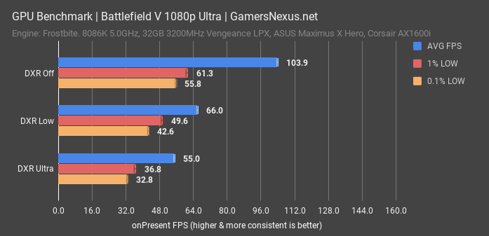

Gamers' Nexus did some testing:
https://www.gamersnexus.net/hwrevie...-founders-edition-review-benchmark-vs-vega-56
Granted it's sub-60 fps but still playable though especially at DXR = low.
We’ll give the 2060 credit where it’s due: It is able to play this game at 1080p and roughly 60FPS with ray-tracing enabled, although it does lose about 40% of its performance in doing so.
Unless you're using a VRR display with really wide effective refresh, all three scenarios will be less than ideal. With a non VRR 60hz display, the top (off), would be the only way to avoid a pretty unpleasant jittery experience imho.
Of course, with Freesync being supported now, it's more likely that someone could afford or already has a monitor that would make the experience at least passable. So that's a real bonus.
