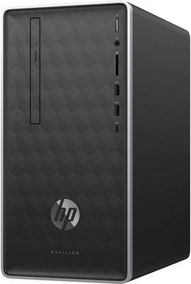

Now im torn between the HP pavilion 590 i5-8400($400) vs a Acer Aspire TC Desktop Intel Core i5-10400($300).
Acer has dual hdmi and HP sas hdmi and vga. Not sure if i want vga for my dual monitors. I don't want to spend to upgrade the GPU.
HP is probably better quality but has 14 day warranty only. Acer has a 2 year warranty but lesser quality.
$400 vs $300.
haha im torn.
Thank you for your suggestions again.
