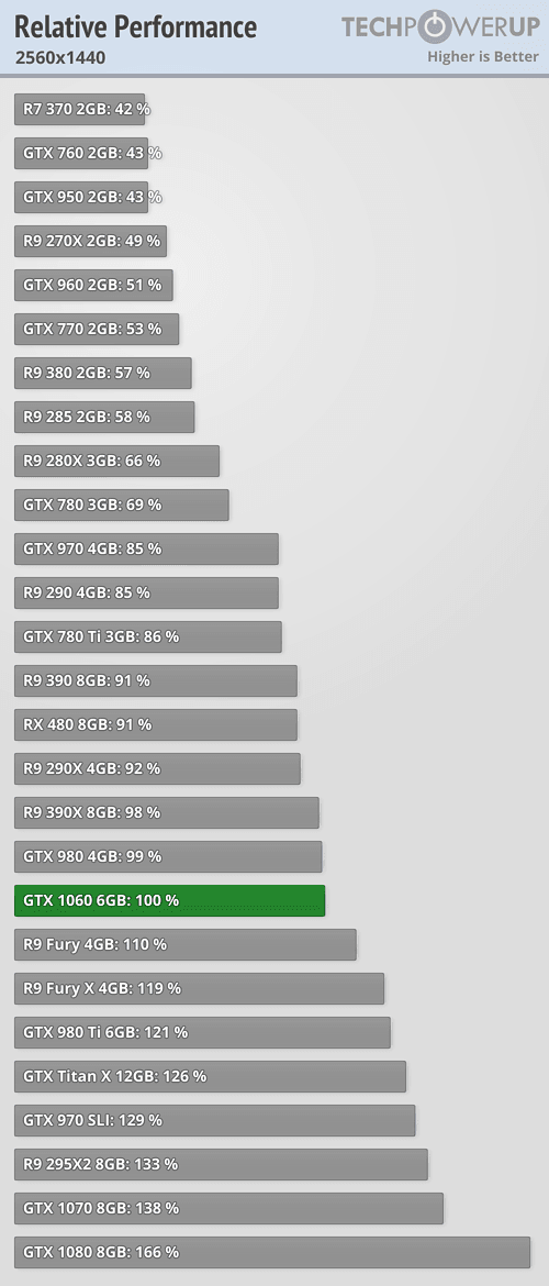

Go to gamegpu.com to see reviews of new games with older cards including 770 and 7950. They don't have a 280, but they have 280X. Seeing as a 280 is a factory overclocked 7950 (the 7950 here is the dreadfully low 800MHz version), you could guess its performance to be somewhere inbetween 7950 and 280X (perhaps the vanilla 7970 is comparable).
Traditionally 770 was faster, but Kepler is sort of hit or miss now. You'll see all kinds of scenarios: where it's 2012 proper order and 770 is ahead, but also where Kepler is neglected in drivers / dev support and it's a draw or even behind. But decide for yourself rather than listen to partisans if you are going with Kepler vs GCN 1.

That's a great deal. You won't find anything better. R9 280X > 770 2GB or 4GB. The more demanding a modern game is, on average, the faster R9 280X will be against GTX770. Since the CPU you are pairing with will be slow to begin with, might as well save as much $ as possible in the R9 280X vs. 770 class. In that case, it's an even stronger case for an $85 R9 280X. If the 770 you are considering is 2GB, I wouldn't buy it at all.

Not can be slower, but it is actually slower. AMD has by far superior drivers and performance for AAA games released in the last 5 years for R9 280X compared to GTX770. Reviewing GameGPU's data since November 2014, 770 is getting blown out by R9 280X/7970Ghz in many titles.
