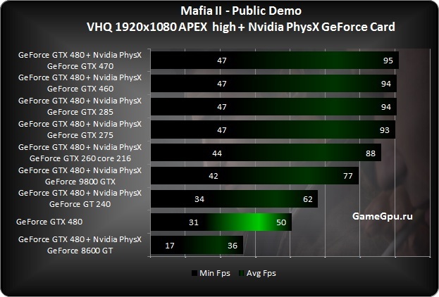

its a fact that based on benchmarks, a gt640 has about the same power as a 9800gt. well here is some reality for you. here you can see a gtx480 with different cards being used for physx. now factor in that a gtx580 is 20% faster than a gtx480. that would make the baseline about 60fps. so a gt640/9800gt level card would be below what that 9800gtx is given here in Mafia 2. and this with just ONE gtx580, with TWO gtx580s a freaking gt640 would be slower.

toyota
Apr 15, 2001
12,957
Sorry, not an avida nVidia user, so I really don't follow their CUDA core count and stuff as closely.
So, with that said, which would be better for PhysX Offloading:
GTX 460 SC vs GT 640 stock vs GTX 650 SC?
Off the top of my head, the 460 is clocked around 850mhz, the 640 was clocked like 980 or something, and the 650 was clocked 1058. The clocks aren't exact, but it's what I remember. The 640/650 both have 384 cudas vs the 336 of the 460.
the gtx460 will certainly be the faster card for physx by far.
