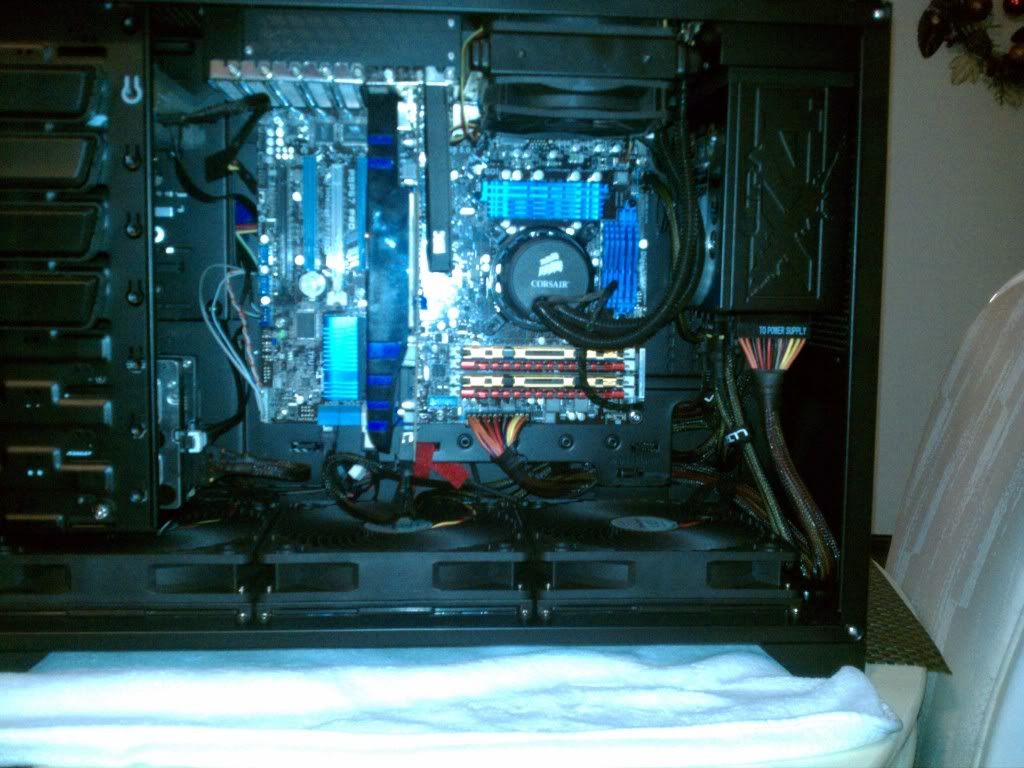

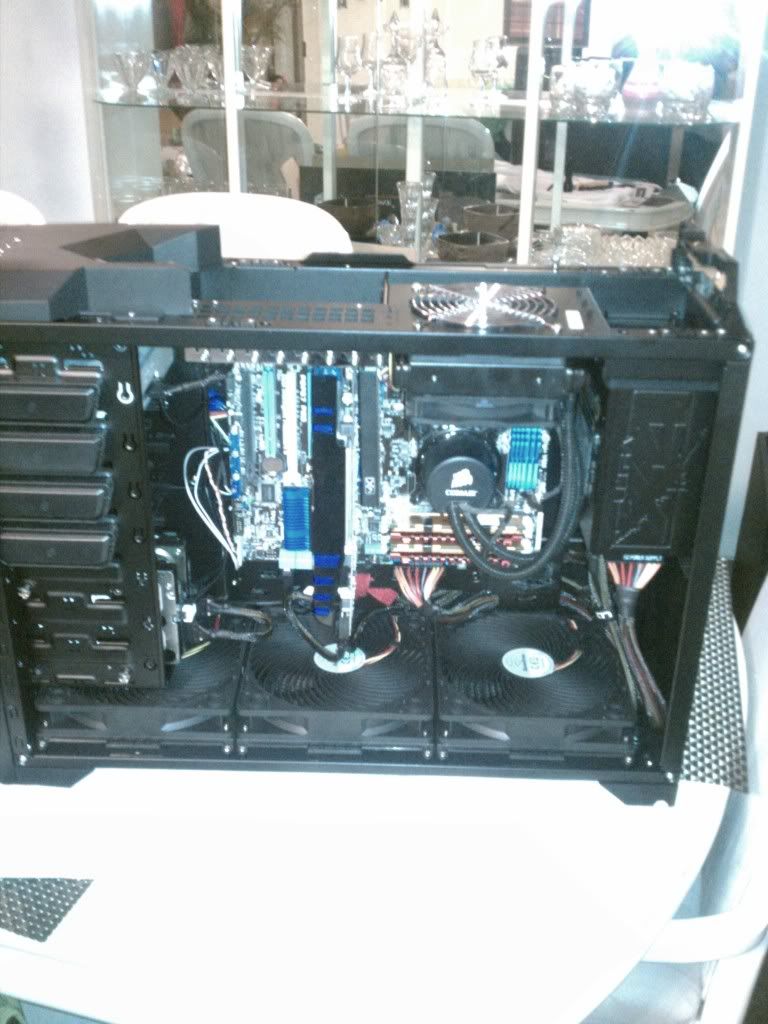

I have a Gigabyte 7970 GHz edition. I bought it from Amazon warehouse deals for $256 but when I got it the fans where not spinning so I decided to RMA the card since I got it for a really good price. I got the card back and fans are working fine now. I have been monitoring the fans though just to make sure and I have noticed something weird. Idle temp never goes below 43C. The fan speed does if the GPU reaches 43Cs. Load temp never been more than 67Cs even after playing Metro 2033 for several hours non stop. Fan speed varies a lot though from 60+ to as high as 79%. I have a raven 2 Full tower case that has really good airflow and fans:

I use the fans in low for the case so that it is silent. I crancked the fans to high and the fan speed on the 7970 never went over 73%.
Now I am wondering if removing the factory thermal paste and applying some ARCTIC MX-2 would let the fans on then 7970 run cooler since the card seems to have a 43c bottom temp and 67c top temp and run quieter.

I've read that some GPU coolers have issues with the rotated motherboard design of the F2. It's often said that this case works best with blowers. This could account for the unusual temps and high fans speeds you're seeing.
