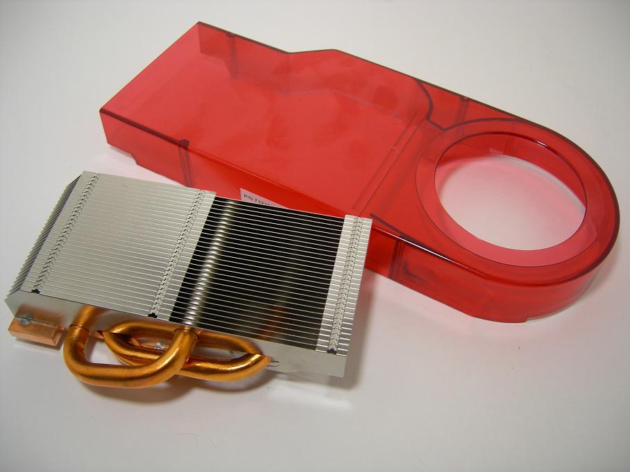

you can buy on ebay for $15,
but about using a case fan, I think it really depends on the heatsink design,
if it's this model:
at least half of it it's closed on the top,
I'm not sure a case fan is going to work well
