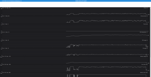

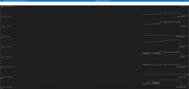

Here, I have attached 2 images, 1st image is recorded when the crash happens & the 2nd image is post reboot, when the crash does not happen. They are recorded using MSI Afterburner.
In the following log, its visible when the crash happens. Everything including the power draw instantly drops to ZERO:
Here, in this log, I simply play the game for around 10-12 minutes and then exit the game normally:
So, the occurrence of this crash is almost simultaneous in nature.

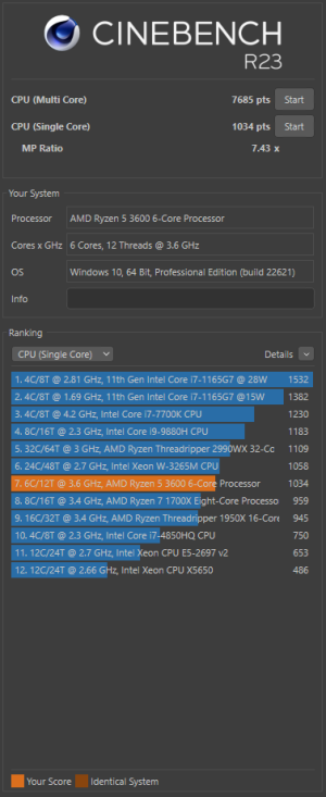

I just stress-tested my CPU using Cinebench. Nothing happend. Screenshot is attached.
As far as I know, if there was something wrong with the CPU, the stress test would have crashed, rebooted or BSOD'ed the PC.
