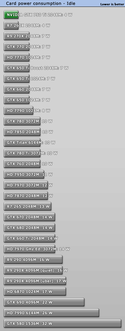

R7 260X and 750TI both uses very little power at idle
But 750Ti is more efficient at load:

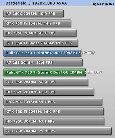

I think a cheap gtx750ti will play StarCraft 2 at 100fps and be just fine for occasional Photoshop duties.
Here is a ASUS overclocked out of the box version for 105$ AR.
. Runs cool and quiet, and most importantly uses only about 70 watts.
http://www.newegg.com/Product/Product.aspx?Item=N82E16814121855
AND for those who like the r7 265.
When both the gtx750ti and 265 are overclocked guess what cards wins?
The gtx750ti.!
and the 265 dumps double the heat into your case than a gtx750 ,43 more watts.
Really! You snagged graphs from a review that was done in Feb 2014. Most likely the numbers are no longer applicable as far as todays performance goes.
http://www.techspot.com/review/783-geforce-gtx-750-ti-vs-radeon-r7-265/

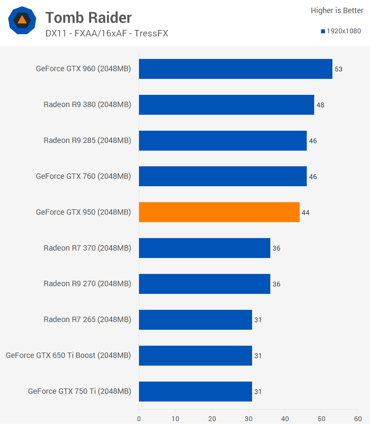

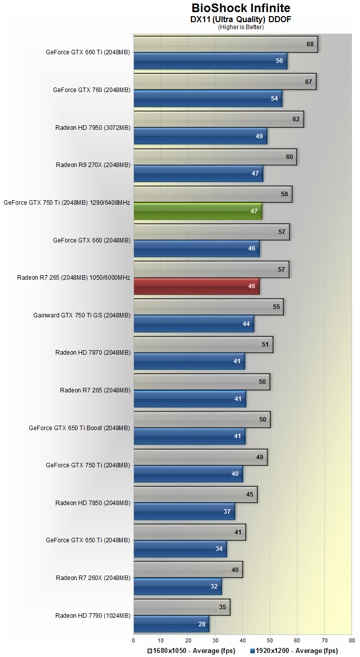

In the stock clocks in those games the 750 Ti is right on the heels of the 265. That's not a typical result in 2015.
Bioshock Infinite, it has a 750 Ti -1 FPS to a 265 at 1080 at stock, and +1 FPS to a 265 both max OC.
The modern era, same website, same game:
6FPS lead for 265 at stock
Tomb Raider, the 750 Ti has a +4/+2 lead stock/max OC.
Equal at stock.
So even in 2013 games AMD drivers have made gains, as is standard and typical.
I invite you to look through the rest of the August 2015 review and see the results between 265 and 750 Ti:
http://www.techspot.com/review/1049-nvidia-geforce-gtx-950/
In modern games the 265 is just faster, as you can see for yourself in that review.

Why is it that nobody actually reads my post?
I said that the gtx750ti overclocked vs the 265 overclocked the 750ti would win and use 43 watts less power. and showed overclocked graphs to back it up. Both are the same price, so whats the problem?
In my world where just about everyone on this forum overclocks or should overclock there cards it matters.
The guys plays StarCraft 2 once in a while, who cares if the 265 is a bit faster at stock.
