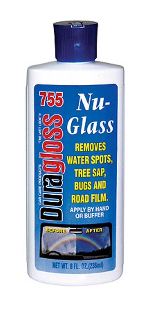

Speaking of which, I recently discovered a product that removes etched watermarks from glass. I tried it on my windows. Surprisingly effective. $8.53 for 8 oz on Amazon.

Duragloss 755 Automotive Glass Water Spot Remover - $9

The Duragloss? Not worth it. Yes, it works for *very* minor stuff like water spots and maybe some super fine spiderweb type scratches but did it really get all the metallic looking flecks out of my Jeep's windshield? Nah. As soon as the sun is going down, it'll probably look like an explosion of pixie dust happened on the windshield. It looks better, just not that much better. Again, I spent probably 20-30 minutes just going over that small stupid windshield with a DA and glass polishing pads. Very little difference before and after but there is *some* difference. Not a dramatic difference like you'd hope. I haven't tried the Cerium Oxide yet but I will. If you know anything about YJ windshields btw, you know it's a PITA. (windshield wipers FTL)
