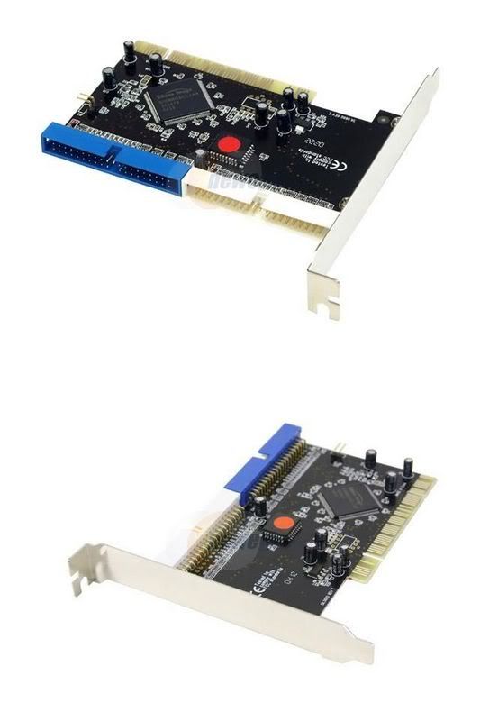

This one is the one I try to keep on hand : http://www.newegg.com/Product/...x?Item=N82E16815124001 , but the last time I looked the price was at $25. + sh. Now that they have this deal going, I should grab another... It comes with only one cable so if you need another it would be wise to order them together. The $20.00 Sabrent card: http://www.newegg.com/Product/...x?Item=N82E16815123009 is pretty much the same - if it comes with two cables it might be worth the difference. It only has one cable but it is made in Taiwan instead of China so it might be worth the extra anyway - besides it's red... 😉

I've never liked Kouwell stuff - I've had stuff like undersized PCI plug (card could shift in the socket and contacts then don't lline up, etc.) Besides, you put it side by side with the Syba card and I'll be surprised if you can see a difference. Here they are one above the other: http://i52.photobucket.com/alb...pper0/side-by-side.jpg . But you can pay a lot more for the same card if you want - buy it with the Startech name on it... :roll: .
