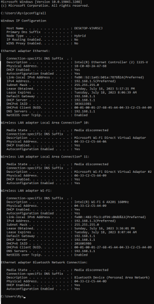

Looks like the IP assignment is set to DHCP. I don't pretend to understand most of what shows up under ipconfig, but this is what it returns. Trying the manual DNS now. Didn't occur to me that it could be the OS either. Good deal.

Looks like both are suing the gateway as the DNS. Different IPs so, there shouldn't be a conflict. One would think of one works the other should work as is.
Works wired to ISP box but not routers is odd. And we know it's across multiple routers so it's not a bad router.
Curious what DNS it's using when using the ISP directly.
One thing comes to mind being an Intel 225 there's been some funky issues with those depending on the version. Still might opt for a nic swap before torturing yourself with an os reload.
Depending on the CPU you could upgrade the wifi card while you're in there for an ax411 which enables bonding of 2.4 to 5ghz to provide a total of 1.5gbps if your router supports more than 1ge. They're cheap through mouser at $18/ea and enable 6ghz as well.

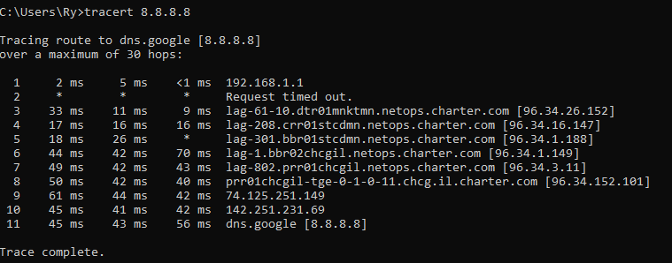

Been suffering from a terrible connection all day on wireless - don't know if this is related, or a bonus gift from Charter Spectrum.
Results of tracert 8.8.8.8 below:
