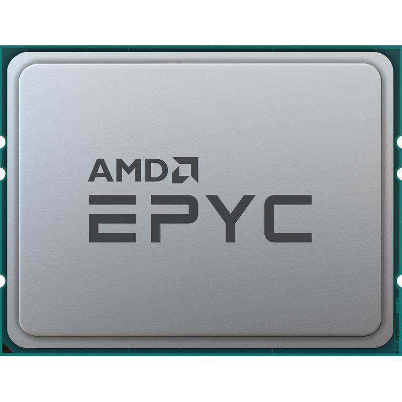

see my edit. $275. I mean if he wants ECC and dependability, EPYC is server grade and totally reliable and server quality.
