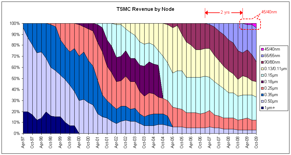

ilkhan I went ahead and pulled the data and graphed it in a way that I hope better communicates why I say Globalfoundries pursuit of establishing a bulk 45/40nm process flow has opportunity to grab a healthy chunk of the global annual foundry revenues even if it isn't ready for another year yet.
Graph of TSMC's Revenue by Node over the past 12 yrs
First thing to notice is just how much existing revenue is derived from what we enthusiasts consider to be decade old technology...look at the 0.15um numbers, heck even look at how much revenue still ships on 90nm.
Now notice just how tiny of a blip 45nm has made to date in that upper right hand corner. Compare that to the tiny blip that 65nm was just 2 yrs prior. Now look at how little the revenue by node landscape changed in the 2yrs since 65nm (and 55nm) was introduced. In 2yrs that 65nm process tech at best snagged about 25-26% of the revenue for TSMC, the rest of their business was quite happy to stick with the older more mature technologies.
So how much of this revenue by node landscape can we really expect to change over the next year or two? At best it will change by the same amount as it did in the past two. Meaning whenever Globalfoundries brings their bulk 45/40nm process online there will be PLENTY of customers out there still on 65nm and older technology to go courting after as they slowly transition some of their products to 45/40nm node tech.
