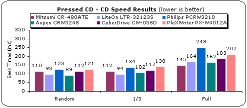

"I'll avoid mentioning the reliability issues, since you're doubtless aware of them. I avoid Lite-on due the fact that it only has a 2mb cache buffer, high seek times, and generally substandard performance in comparison to market leaders like Yamaha, Plextor, Teac, AOpen, and Sanyo. See CD-R info for more if you doubt me. You can buy Plextor's new 40x drive for $165 from some places now."
Ahhh...more FUD...let's pick apart the incorrect parts of your statement one by one shall we?
"I avoid Lite-on due the fact that it only has a 2mb cache buffer"
Hmmm..seems to me until the 24X and above models, Plextor used the same 2mb of cache as other models. Almost all 24X and up burners use a 2mb buffer. The buffer size is not very important with burn-proof and similar technologies. Let's look at the "market leaders" you mentioned..
Aopen 24X - 2mb Buffer
Teac 24X - 2mb Buffer
Sanyo 24X -2mb Buffer
Lite-On - 2mb Buffer
The Plextor with 4mb and the Yamaha with 8mb are the only exceptions.
"high seek times"
Hmm.. If you look at this review of the Plextor 24X from the very CDR-Info site you mentioned, the Plextor comes in last place with an average seek time of 155ms while the Lite-On is first with a 90ms seek time. The Sanyo and TDK models come in second and third.
"and generally substandard performance in comparison to market leaders like Yamaha, Plextor, Teac, AOpen, and Sanyo. See CD-R info for more if you doubt me. You can buy Plextor's new 40x drive for $165 from some places now."
Hmm.. If we look at the review of the Lite-On 24X, you will see that it is one of the highest performing 24X CDRW's on the market..and even the supposed "king" of the 24X drives, the Plextor, loses as well as wins some tests when compared to the Lite-On. Essentially the difference is performance between the two is very little. CDR-Info also made these comments at the end of their review of the Lite-On..
"LiteOn's attempt at the 24x writing speed is much more than satisfactory. The LTR-24102B seems to be the faster recorder, for now, and managed to outperform both Sanyo and TDK 24x drives in many reading/writing tests. The drive's overall performance was very good and -for sure- users will enjoy both 20x and 24x writing speeds. Other important features such as: support for SD2 protected discs, overburning (up to 99min) and reading/writing SubChannel data are present."
Another thing to keep in mind is Lite-On has been in the optical drive business for over 20 years, and have just recently moved into the retail market. Their drives have been used by OEM's for a good many years, and I think you will agree that drives that die easily or don't last won't get much support in the OEM sector. Your personal preference is fine, but before you spread misinformation, you might want to read up on your facts...:)
<< Hmmm..seems to me until the 24X and above models, Plextor used the same 2mb of cache as other models. Almost all 24X and up burners use a 2mb buffer. The buffer size is not very important with burn-proof and similar technologies. Let's look at the "market leaders" you mentioned..
Your point? I usually tend to avoid drives with 2mb caches, period.
<< "high seek times"
Very good, actually. Thanks for correcting me, though the Teac still beats it with around 80ms seek (source: Tom's). I'll be more careful about throwing around crap about Lite-on's seek times in the future. Plextor's 40x has better seek times (view the graph here: http://www.cdrinfo.com/Sections/Articles/Sources/PleXWriter PX-W4012A CD-RW/Images/data-cdspeed1.gif), but still not as good as Lite-on (though the AOpen seems to have a slight advantage). Anyhow, the point is conceded--I stand corrected.
<< Hmm.. If we look at the review of the Lite-On 24X, you will see that it is one of the highest performing 24X CDRW's on the market..and even the supposed "king" of the 24X drives, the Plextor, loses as well as wins some tests when compared to the Lite-On. Essentially the difference is performance between the two is very little. CDR-Info also made these comments at the end of their review of the Lite-On.. >>
My reference to market leaders was in deference to technology development, though Lite-on, in light of the new facts that you've enlightened me with, has outstanding performance. For king of 24x drives, I still believe that Yamaha would win with its P-CAV, but that's another matter. Again, I stand corrected.
<< Your personal preference is fine, but before you spread misinformation, you might want to read up on your facts...:) >>
I'll definitely make sure to do that. My prejudice against Lite-on developed as a result of an RMA issue I had, and I suppose that this became perverted into mistaken notions about the performance of the Lite-on drive. Anyhow, thank you for correcting me.
In deference to these new facts which I neglected to research myself, I advocate the purchase of the Lite-on drive, as the RMA issues have now largely been cleared up.
