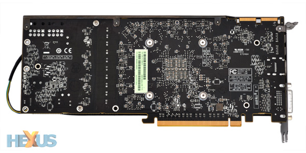

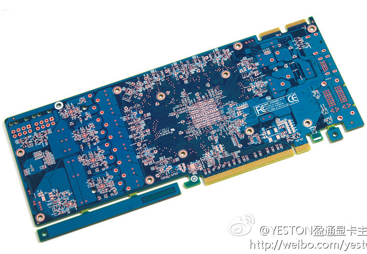

The PCB in that review is black, and the one on Newegg is blue. Different card?
PCB in Hexus review is 100% reference.
PCB in Newegg is different color but still is using reference design/components.
PCB is not a Gigabyte Ultra Durable, or else it will say so on the packaging.
The PCB is still using reference design but is manufactured from Gigabyte's sources. My guess is Gigabyte will release a custom "ultra durable" pcb on a updated revision of this card.
Wonder if it's the alternate budget PCB without the AMD logo pictured here? http://twitarmy.com/community/showthread.php/439-AMD-Radeon-HD-7900-PCB-Pictures-Leak-To-Web
It doesn't look like Gigabyte is using the budget pcb.
If you look at the hsf mounting holes on the end of the pcb near the power connectors you'll notice that the Gigabyte card matches the reference pcb and not the "budget" pcb.
The budget pcb only has two mounting holes at the very end of the pcb while the reference has four.
Gigabyte 7970 pcb
7970 refrenece pcb
7970 budget pcb
