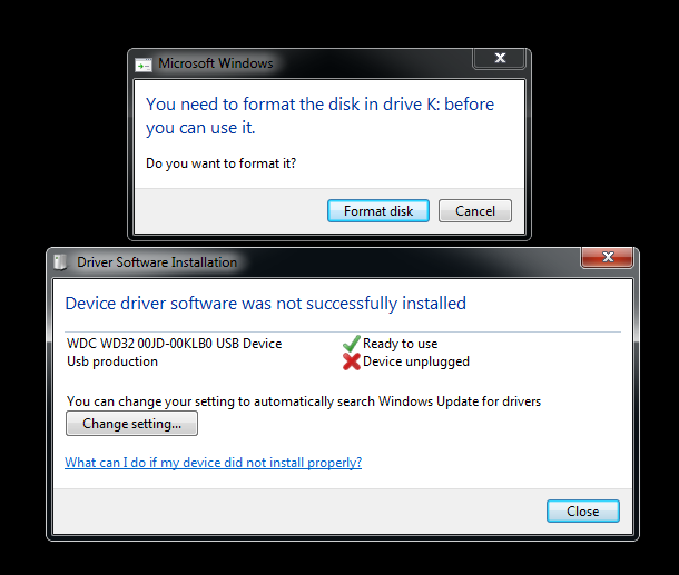

When I put a drive in and turn the dock on, it first said it was installing the driver and then that the driver install failed. The drive would sometimes appear for a second and then disappear. If this happened, Windows Vista (H55) and Windows 7 (P67) would tell me that the drive needs to be formatted (which it actually does not).
The device also has a weird name when connected to the Gigabyte mobo... I don't remember what it is off the top of my head, but it's not the usual term you see for a USB adapter. I did see the usual term used on my ASUS-based machine.

I updated the drivers, but it still doesn't work. I get the same errors as before:
http://i93.photobucket.com/albums/l51/shin_aikouka/usb_error.png

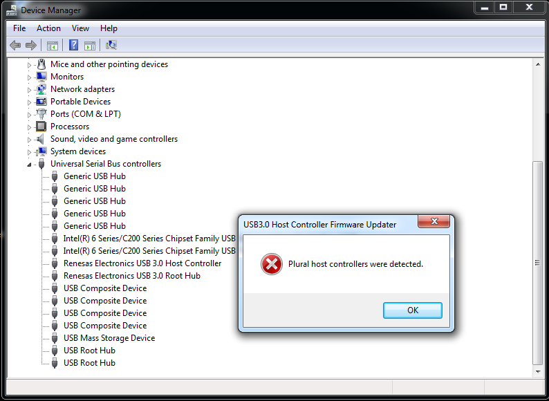

It seems that I cannot perform the firmware update because I have more than one USB 3.0 controller on my motherboard. I wonder if disabling it in Windows will work or if I have to find an option in the BIOS.
EDIT:
Actually, I think my firmware might be newer than the ones on that site. If the ones on that site are 3021, mine is listed as 3025 in the USB 3.0 Host Controller Information application.

No luck, Vailr. I simply cannot flash my firmware because I apparently have two controllers. I went into the BIOS and disabled the Front USB 3.0 controller, but Windows still reports that I have two (and so does the Renesas USB 3.0 Host Controller Information application).
The flashing application does not support multiple controllers, so it will not let me update.

@Aikouka:
Did you try: right-click & uninstall one of the controllers, in Device Manager?
Then run the firmware updater program, which shouldn't be able to detect any USB 3.0 controller except for the one that's still "installed" in Device Manager.

@Aikouka:
Yeah, I tried that before and it didn't work. I tried it again just now and took a screenshot:
http://i93.photobucket.com/albums/l51/shin_aikouka/one_device_firmware_fail.png

@Aikouka:
May need to also (after right-click uninstalling one of the USB 3.0 controllers in Device Manager): reboot, enter the bios and disable that same USB 3.0 controller within the bios setup. And: while there are no USB devices that are connected to any of the blue USB 3.0 ports.
Didn't work. I removed both USB 3.0 controllers, restarted (I already have the front controller disabled) and they're both still there.
