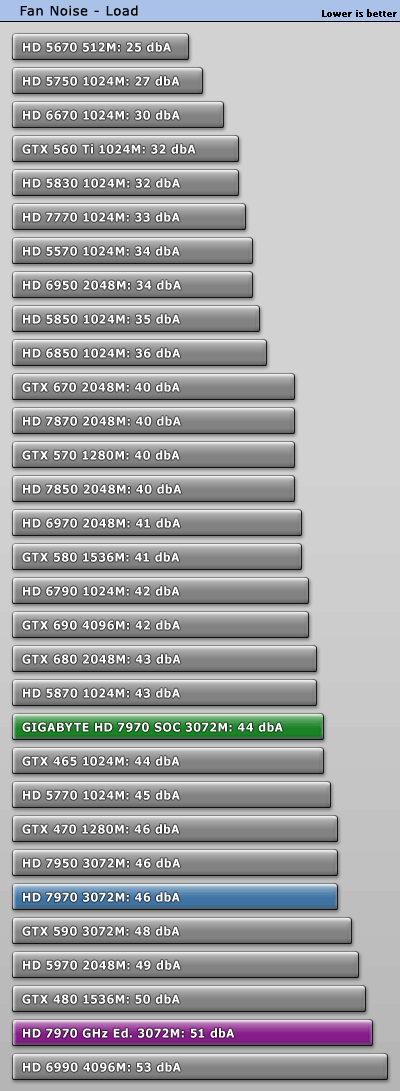

The noise levels are decent for 5 fans:

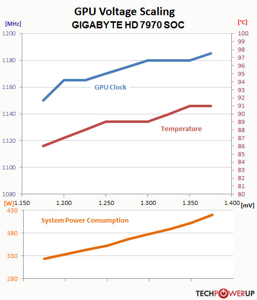

Default voltage overclocking. Look at that memory overclock:
The card didn't do well with voltage overclocking though and the fans ramped up to 8000 rpm trying to deal with all the access power heat!
Looks like the build quality of the card/PCB/VRM/power circuitry is great but the cooler design is a let down.
W1zzard said he put 1.4v through it! No popping VRM's. :thumbsup:
Very high quality PCB/components, but lackluster overclocking in that sample. Power consumption increased almost 100W going from 1080mhz to 1180mhz with voltage bump from stock to 1.35V. There are plenty of cards that do much much better on air than that. I think this card is pure gold for water and LN2 cooling but a flop for air cooling. They have picked low ASICs % for this card which means it's really not great for air cooling at all.
W1zzard is one of those reviewers that simply cranks the voltage slider and sees how high it will go. He certainly isn't big on optimizing the O/C. Also, the cooler is retarded. Look at the HIS cooler. 2 slots, 2 fans, and it works brilliantly.
I'm just impressed with the ability to handle that voltage.
