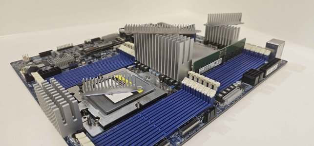

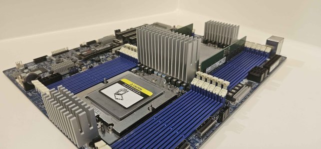

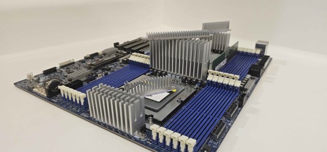

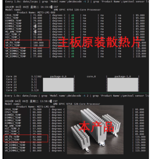

I upgraded the VRM heatsinks on my dual SP5 board the other day. Figured this should help prevent them from getting too warm and over heating causing the CPUs to throttle which happens frequently on my Rome setups if I don't have some kind of active cooling aimed at them.
Forgot to take before pics of what they looked like stock. Thought I had one floating around from when I first got it, but I can't seem to find it or I didn't actually take any.
So I tossed the stock heatsinks in the pic next to the upgraded ones for comparison.

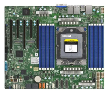

Show off. Don't think those will fit a H13 SuperMicro board...

No they won't. They're a little bit longer than the h13ssl heatsinks. I compared them. But a Dremel and drill could make fit.

Mark, those aren't the issue with mounting them on that board. The mounting holes are in different locations. I think you'll need to cut a fin off the heat sink and drill a hole in it. IIRC, the holes on the SM are closer together than the Gigabyte. Those heatsinks are like $75 shipped though. Not exactly cheap for me to buy them and try it at this moment.

Can you share ipmi sensor data with vrm temp on full load? I think you set 400 Wt tdp on cpu? I'm choosing between MZ73-LM0 and MZ73-LM2 for same 9b14 cpu. LM2 have better VRM for 500 Wt tpd but it cost more money.
What temp you have on LM0 with custom mosfet heatsink.

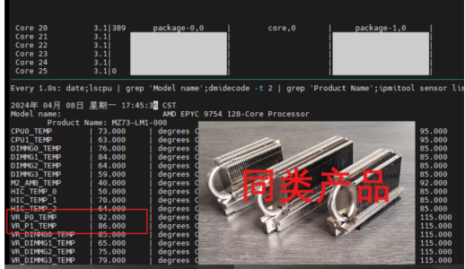

CPU tdp set on 400 Wt? not default 360? Mosfet heatsink has fan above or not have some airflow? Now i use h13SSL with 9v74 cpu (400Wt) and have near 65C on vrm. with custom heatsink.

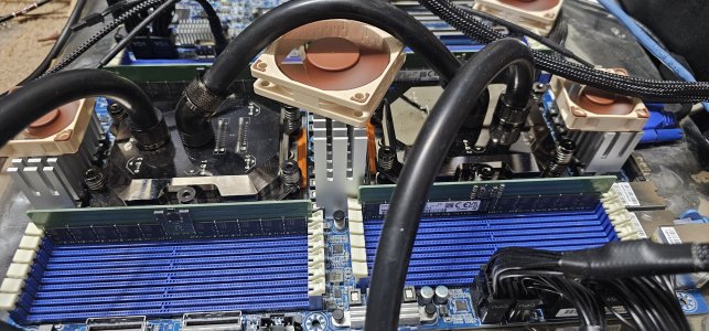

No, no fans on it directly. Its sitting in a room that's currently around 85F though so the ambient temp is pretty high. Yes it's set to 400W TDP. My other H13SSL is also set to 400W TDP, no custom VRM heatsinks and also under the same load with 100% of the threads working (192 this time) and its temps are around the same as the dual socket motherboard temps. The H13SSL is also being cooled with a water block on the CPU and in the same room that's 85F. However, it does have those noctua fans resting on top of the VRM heatsinks. Not real sure they're doing all that great of a job.

When i use h13SSL without custom heatsink, i have near 90C and more on vrm with 400Wt tdp, with custom heatsink i have near 65 with 2 fan installed on front of the case. I use same bykski waterblock for sp5. And when i find custom heatsink (the same as you use ) for mz73-lm1 on chinese taobao i saw scenshots with ipmi sensors readings.
Now i think buy more expencive mz73-lm2. Cuz it have more robust vrm.

I don't remember what the VRM temps were before I switched them on the dual board. I just knew the VRM temps are an issue on EPYCs as I have had issues with my Rome setups throttling heavily due to them getting to hot. So nearly all my Rome setups have fans on the stock heatsinks to keep them in check. Which is why when I built this system I immediately went looking for alternative ways to cool them as this particular system will be placed in an actual case. The Rome setups are all on the "open air mining rack" type setups as they all have multiple GPUs and it's just easier on maintenance and setup with the GPUs on riser ribbons out of the way.
