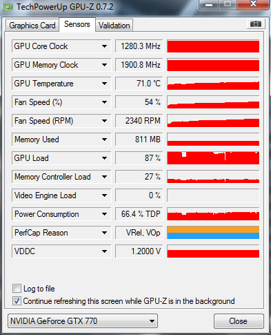

This is a screenshot from a review and it showing this card showing the voltage increase has been applied and the monitor tool is reading 1212v correctly.
And this is another screenshot, voltage increase is applied but the monitor tool still showing 1200v

Precision-X is reporting Voltage Limit = 1 what ever voltage is used 1.200v or 1.212v
