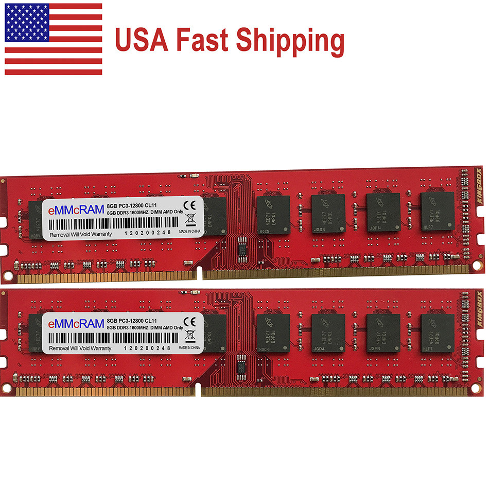

Interesting that new DDR3 is so much cheaper than new DDR4 at Newegg:
https://www.newegg.com/Product/ProductList.aspx?Submit=ENE&N=100007611 600006072 8000&IsNodeId=1&bop=And&Order=PRICE&PageSize=36 (2 x 8GB DDR3 1600 starting at $109 shipped (this for Silicon Power) and $115 shipped (this for G.skill value))
https://www.newegg.com/Product/ProductList.aspx?Submit=ENE&N=100007611 600006072 8000 600561670 600561671 600561672 600561673 601302872&IsNodeId=1&bop=And&Order=PRICE&PageSize=36 (2 x 8GB DDR4 2400 starting at $160 shipped (this for Team Elite Plus). The DDR4 2133 is actually more expensive).
But the AMD specific 2 x 8GB DDR3 1600 (below) is the cheapest overall at $73.90 shipped on ebay.

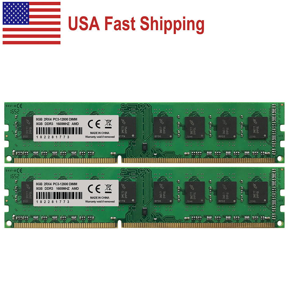

cbn
Mar 27, 2009
12,968
221
Found some more AMD specific DDR3. This from a US Seller on ebay for $77.42 free shipping (2 x 8GB DDR3 1600) :

I emailed both ebay sellers (a couple hours ago) and both wrote back the RAM was compatible with this GIGABYTE GA-78LMT-USB3 R2.
Furthermore I even found the following comment under the listing for the red sticks:
AMD ddr3 1066 Ram High density memory
Great value ram for AMD chipset. Running 16 gigs of this stuff with a gigabyte 78 LMT-usb3 board and AMD 8320e black 8core processor. Works well going to have to buy two more and see what happens.
SIDE NOTE: Not sure why it is being described as DDR3 1066 though.
