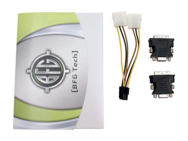

It does not seem have an extra power connector. There is a power connector on the board which seems to power the fan, however it starts inside the fan, and is plugged into the video card. It has 2 wires, red/black, and it seems to be one of the small power connectors. I don't know the proper name for it, so I'm not sure if that's the 4-pin your asking about, or if it's the answer I don't have one, which seems to be the case. Should I check for more connectors and perhaps get the extra cable you speak of in the other thread?
About the bios reading, where can I find that? I've found a heading in the PC Health Status of the bios that is +12V, which says OK next to it. I'll keep looking around, but I haven't seend anything called 12v rail, any hints on where that might be?
Thank you much!
Is this what you are talking about for the extra connector?
http://images10.newegg.com/productimage/14-143-025-04.JPG
From the following thread, a few posts away heh:
http://forums.anandtech.com/messageview...atid=27&threadid=1528723&enterthread=y
And I'd assume thats so I don't have a ton of power running through the PCI-E slot? It's definitely doable, but with those error codes, I'm not sure if that will help, as the error codes seemed to be related to filesystem based errors. Altho I'm not sure what the WMI data provider is, I'll have to research that more.
