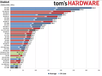

That being said, looking at %1 lows in the retail version, it's obvious that some Nvidia cards are having issues with the game. One could be tempted to think it's a VRAM issue, but you can see the RTX 3090 is struggling just as bad as the 3080. The AMD cards, especially the higher end ones, are punching way above their weight. The game needs better optimization, and will likely receive performance updates in the future.
My suggestion for you would be to first focus on community knowledge about in-game settings that help performance. In other words, try to tweak the game first. One example is the video bellow, which already indicates something that is worth trying to improve some stuttering issues (disable Social > Cross-Network Play):
