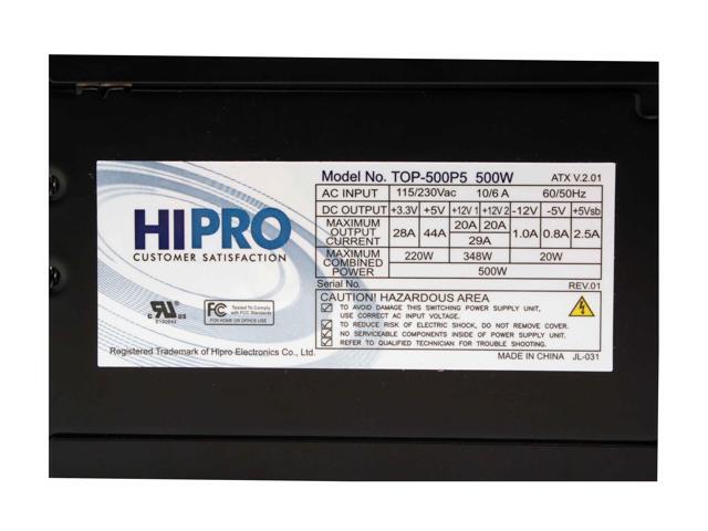

well, considering im running on 15 total 12v amps, 40 total 12v amps seems to be enough, right?
If I were you I'd probably buy an xclio or a fortron around that price. You have to remember wattage really doesn't mean that much, quality components do.
The fact that there isn't even an efficiently rating for that HIPRO PSU would scare me off.
If thats all you can spend I suggest this Forton-Source instead, 350 watts will run your system nicely. A good 500 watt PSU is going to cost at least $70 (OEM Enhance) and most go for $90+ so there have to been some corners cut on that HI-Pro unit to get it to that price level.

Im replacing my old 400watt with only 15 amps. I just wanted to get everyone's opinion before i buy such a critical part.
http://www.newegg.com/Product/Product.asp?Item=N82E16817174023
its a critical part you but your cheaping out on the critical part????
You could do much better by taking Operandi`s advice....
The label on the PSU clearly indicates that the combined is 29A. As others pointed out, quality and lack of "other" specs can be an issue. I'm not thinking of the efficiency, but more like the temperature rating (as in rated output only at low temps).

I know that wattage doesn't have much to do with a PSU's power, but what I DO know, is that the wattage of a psu is directly proportional to the amperage of the psu, so I figured a psu around 450-500 watts would have the amperage that I'm looking for.
What about this FSP instead of that blue one? this one is 400w, with 18/16 amps instead of 350w 10/15a, and it only costs a dollar more
http://www.newegg.com/Product/Product.asp?item=N82E16817104953
Also, can anyone explain how the amperage on the 12v rails don't add up? Does anyone know the equation for the combined current?
You're better off with this PSU than your first choice. Just my two cents. Hope Operandi doesn't get upset with me for offering my advice.
http://psu.thetruck.net
as an example, lets use the corsair 520W: http://jonnyguru.com/review_details.php?id=28
Theres a table in that review that lists the max combined watts. Basically, while there are 520 watts available, there are limits per voltage rail. As you can see, the +12V rails (3 of them) have a max combined wattage of 480W. Therefore, the max amperage available on the +12V rails is 480W/12V = 40A, which is != 54A (what you get when you add up the 3 voltage rails at 18A each). Get it?
