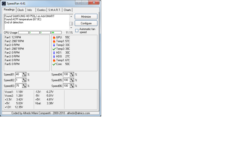

I got some question concerning my Phenom II X4 940 BE. I had it since last year and only did some minor overclock. However, with SC II and upcoming final fantasy xiv coming out, I try overclocking it even more since it is taxing a bit on my system. Anyway, I try ocing to around 3.4 with my arctic freezer 7 pro and following is the temp reading from speedfan, is it too high?

50C isn't too hot for your CPU.
Max safe temp is rated at 62C. <60C overclocked loaded temp is not bad, can you post a reading while running LinX or Prime95 or any other stress test?

well, the 50 degree was during idle, beside with a video playing. Any idea on how to get it pass 3.4? I tried 3.5 but ti give me blue screen when I try playing starcraft II. Do I need more voltage on the core and ram?
Ah. Bad then, very bad. For reference, my load temps are 56-59C, while I Idle at 39-41C, Ambient ranges from 30-33C. If you are already idling at 50C, that just isn't a good sign.
Before even thinking of giving that chip more voltage to try to make it stable, I think we've established now that you need a better HSF. Or, since I am not familiar with your current HSF, perhaps a remount / reapplication of TIM will suffice. Whatever the plan of action is, your first priority clearly is getting those temps under control.

Does that mean my cooler is even worse than the stock one? Also, does having one of the case fan fail would affect the cpu temp?
No your cooler is just on the old side just do your stress testing 50c is very high for idel so case flow may need to be looked in to.
You want to shoot for a full linx pack run where you can stay under 60c if you can do that your be fine in any game.

I'd say 50 C is too high. And in my experience, since I have the same heatsink, it doesn't do very good under full load. Pick up a new cooler.

Well, after opening the case, it turn out my rear exhaust fan is dead. After installed an backup one and run the amd overdrive temp monitor, my cpu temp hover at 40-43 when oc is at 3.47 at idle and approach 60 when it is running games. It nearly freak me out when i didn't know the rear fan was dead, temp approach 75 degree under load when running starcraft II.

Fixing your exhaust fan was a good move, since that was probably causing all manner of problems for other components in your system as well (especially your harddrive). I had thought 50C was your load temp . . . foolish me. A load temp of 60C is not that great, but it's much better than 75C.
Whether you get another CPU or not, getting a new HSF would be a good idea.
