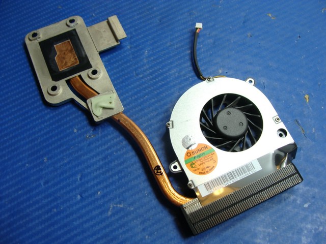

Recently, I've begun noticing a very faint ticking that will get louder when the fan kicks up speed for some reason. I haven't tried to dig into it yet, so I don't know if it just has a piece of gunk sucked in or if a bearing is going. But since it's so old, I can't find any accurate pictures or guides on how to proceed.
I found this one picture of a similar unit, but I'm not sure what I'm looking at as far as the attached piece. I do NOT want to mess with the CPU at all.

Fans do wear out. That is the heat pipe to the cpu, so you will have to remove the whole piece, reapply thermal paste and put it back together if you want to replace the fan, assuming you can find it.
Vaccum it as best as you can and learn to live with the noise is my advice.

Once I do the swap, I can try to find out how to open this one and see how the fan comes out. Hopefully it separates from the tuba thing.

Too old. Generally you have to strip down whole machine or most of it to have access to the heat sink mounting screws.
I wanted to reapply thermal grease to an old studio 17, took off back cover, looked at it then cleaned it as much as I can and closed it back up. There was no way I was going to spend that kind of time.

But the fan itself is under that red box area and I need to split the case to get at it. I think.
Again, I'm hoping to separate the fan and replace it only without disturbing the heat sink.

But it's out. It's dirty as expected, but runs free by hand. May blow it out and try to apply 5V to see how it runs. For $15 or so though, I'll try to get another one.
Bottom cover is not a cover at all. It's the main chassis that everything else mounts to. Had to basically gut the whole thing from the top down --- monitor, KB, Optical drive, a whole bunch of very small ribbon connectors and a hundred or so screws (or so it seemed). Then the MoFo-in' MoBo, since the fan was mounted to the top of it. However, the copper tuba looking thing just slides into a cavity that the fan attaches to.
