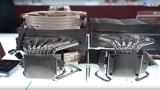

they skipped a step and went to 8 heatpipes. some other tweaks to finstack and an offset option for all previous coolers for amd die centering. it's sad that they have to makes such a twisted convoluted mess of the pipes to accommodate the absurd size of certain brand's graphics cards.

sigh.... a case of MOAR is better...
i think it would of been better to utilize some kind of evap chamber, but i don't know how well those work in a side position.
Fallen Kell
6,240
555
I'm not 100% convinced this is a more is better heatsink, in as much as it is, there is some tech behind it as well. The upgrading of the fans to push/pull more air through a radiator is what let them increase the density of fins within the heatsink's towers compared to the old version. And with that density increase, it made a lot of sense to see about optimizing the number and location of the heatpipes to better distribute the heat into the denser heatsink.
It really wouldn't surprise me that the new version would be able to handle an additional 30-50W over the old version (possibly even more). Will it be the king of air CPU coolers? I don't know, but it will probably be pretty close, especially for the SPL level. It won't beat water cooling for overall, but it also doesn't run the same risks that a water cooler does, and can probably be setup quieter than a water cooling system (pumps are still louder than optimized fans). And it will be much easier to install and maintain than custom water cooling, so I suspect it will sell well once it is finally on the market next year.
Plus, they announced three SKUs with different finish of the cold plate: low/ standard/ high convexity. Apparently, customers will need to select the right model out of these three which best matches their particular CPU. (I don't know if this was mentioned in the GN video which you linked; haven't watched.)
I don't remember if they specifically spelled that out, but they certainly went over the different plates and how they interacted with the difference CPUs, especially the Intel ones as they have found that the retention method that holds the CPU to the motherboard is causing the integrated heat spreader to warp/bend on most of the Intel CPUs, creating a concave dip in the center of the chip (almost like a mini-halfpipe), and that over time it gets a little worse. The AMD CPUs do not suffer nearly as bad a deflection as they have an even thicker heatspreader this generation compared to last and that has added a lot more rigidity.

they covered the concavity issue with Jakob Dellinger from noctua in the video. GN had already been looking into the mating effect of the IHS from intel vs amd and have an earlier video where they worked with scythe to test the effect of matching the surfaces. the scans visualize the actual severity of the concavity.
